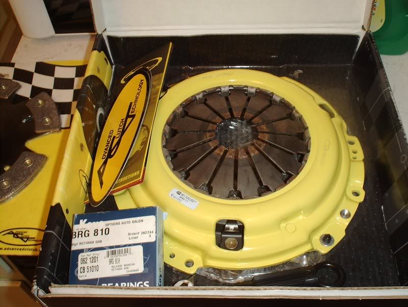

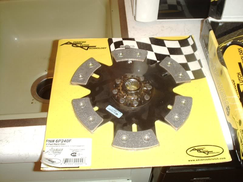

I narrowed my choices down to the big three, Exedy, ACT and Spec. There was a stage 2 ACT in the KA that I pulled so...go with what you know.
Pressure plate part#N-015
Disc part#:6P240F
Thanks for the heads up and the info people!

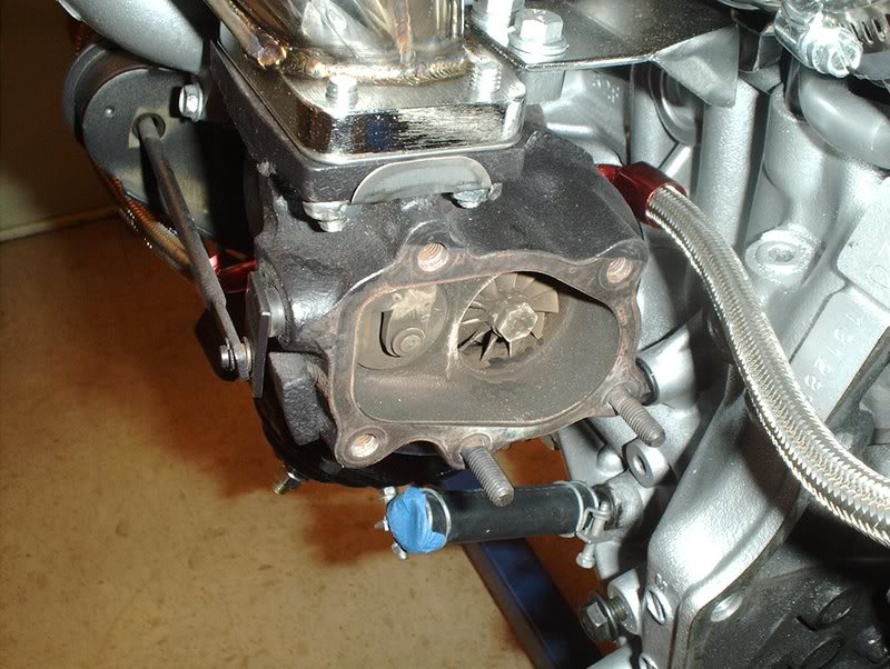

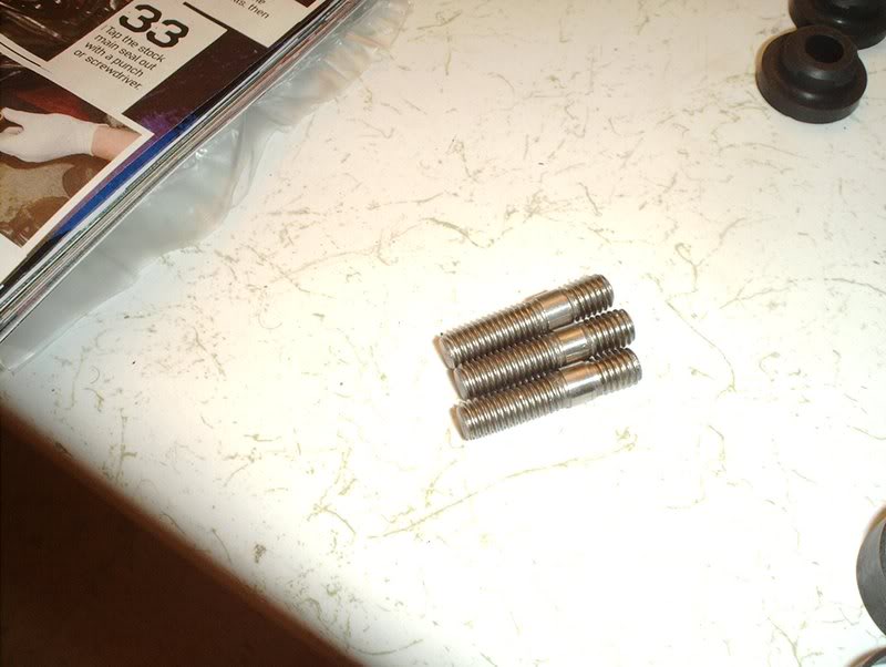

Well, that missing hardware that was supposed to come with my turbo elbow never showed up so I just emailed the seller and said send me $15 and I'll buy the studs myself so I finally got a set.
Tools needed:
Socket wrench
Socket extension
12mm deepwell socket
12mm wrench
Threadlocker
I already have gaskets and nuts so I only needed the studs anyway.

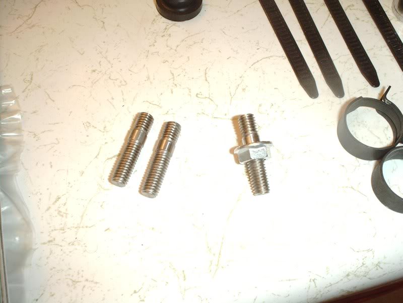

Circuit sports studs thread size M8x???MM.

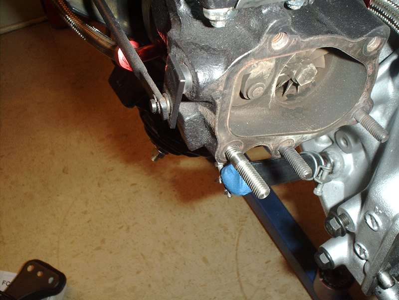

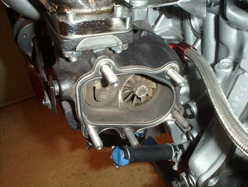

OEM T25 Turbo. There are two studs already on the outlet so I need to place three for a total of five.

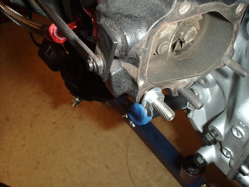

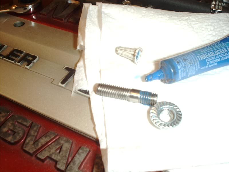

Probably not going to help much but I put a little thread locker on the studs before seating them.
Place them in the turbo and put a couple of washers on the stud...
to keep the nut that you use to seat them from bottoming out and getting stuck on the stud...
like this. I've seated plenty of studs so I should have known this, just impatient and not paying attention to what I was doing is all.

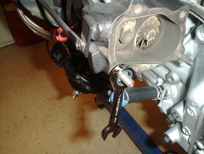

Use a 12mm wrench to seat the studs.
Seat all three studs into the turbo then move to the next step.

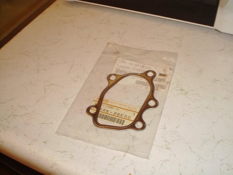

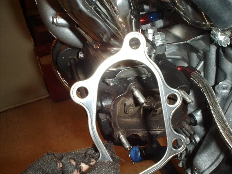

T25 OEM metal outlet gasket part#: 14445-26E00.

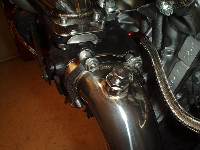

Take the gasket...
place it on the turbo.

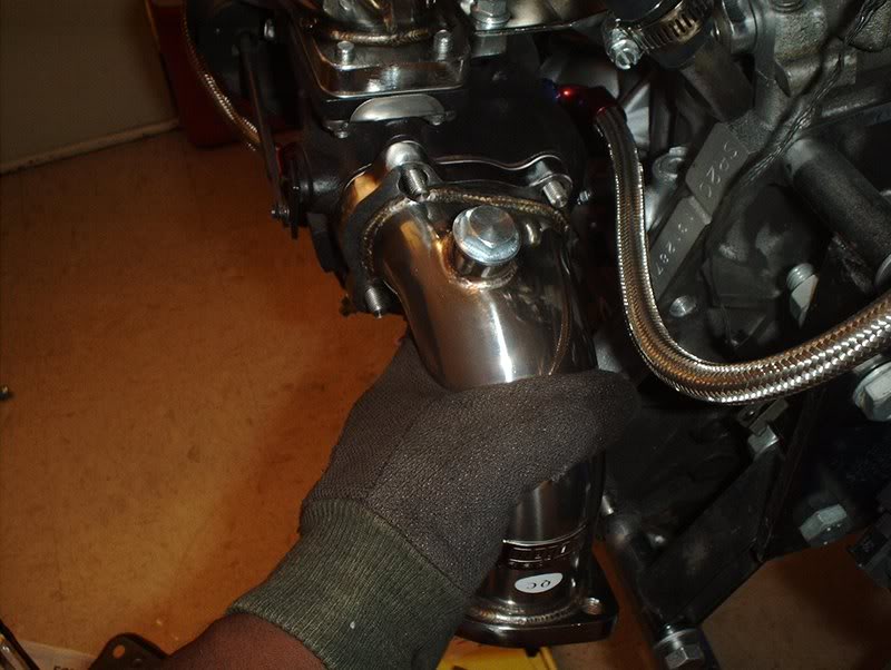

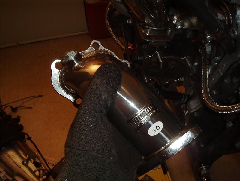

Take your elbow...

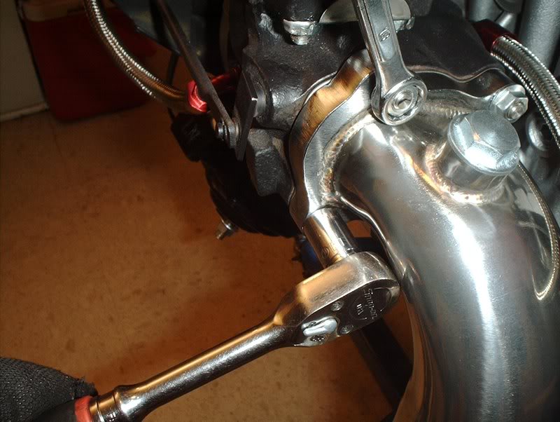

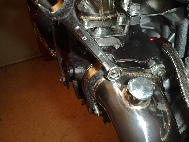

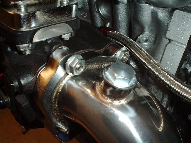

Put the nuts on. You can use M8x1,25 from the parts store. I had to use a wrench here because the O2 sensor port gets in the way of a socket wrench.
Use a 12mm socket, tighten and torque to 16-23ft.lbs.

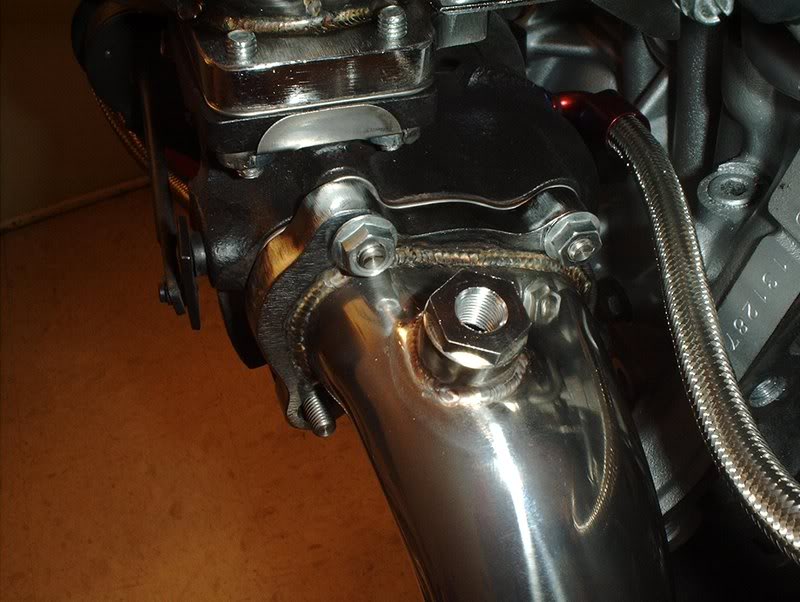

Here is the O2 sensor port. As you know by now, the blacktop and redtop engines have two different O2 sensors. The blacktops have a "fat" sensor while the redtops have a "skinny" sensor.

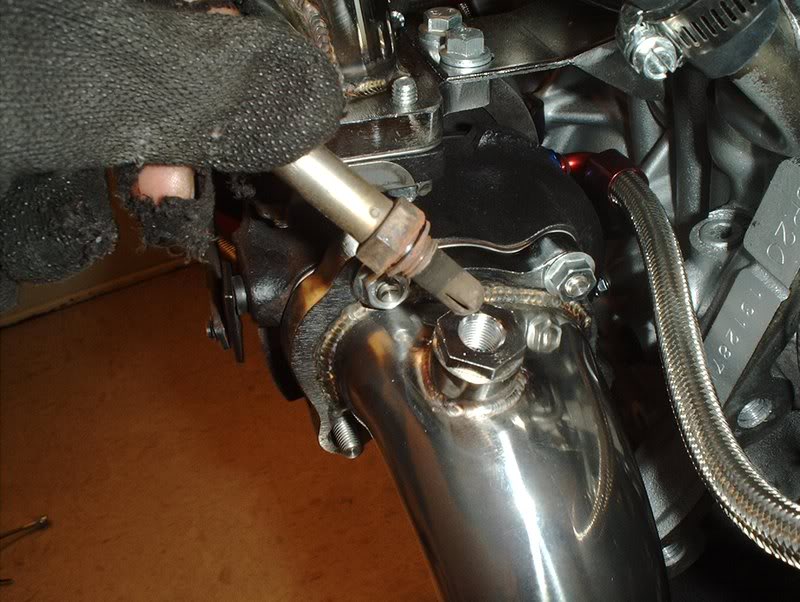

From what I've seen all the aftermarket elbows have a fat O2 sensor outlet so if you have a redtop, like me, then you will need a O2 sensor adapter to accomodate your "skinny" sensor.
This is a O2 sensor adapter. It will screw into the "fat" O2 sensor bung and allow you to screw the "skinny" sensor into that.

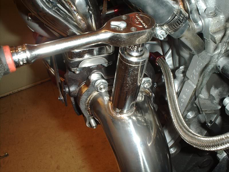

Use a 22mm socket to tighten it, I don't have torque specs on this.

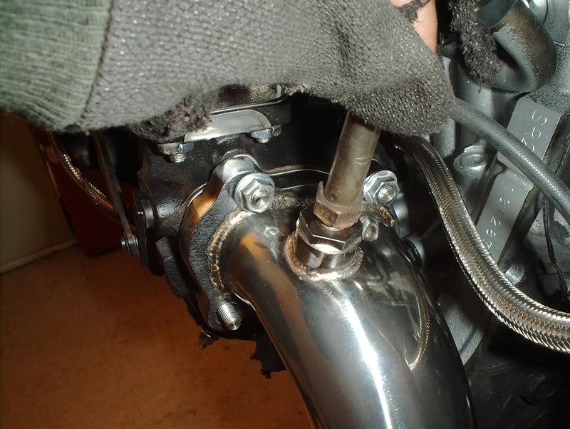

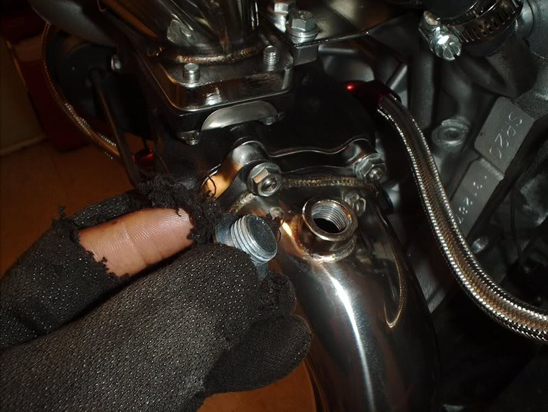

You unscrew the port...
this is my old O2 sensor but you get the idea what has to happen here.

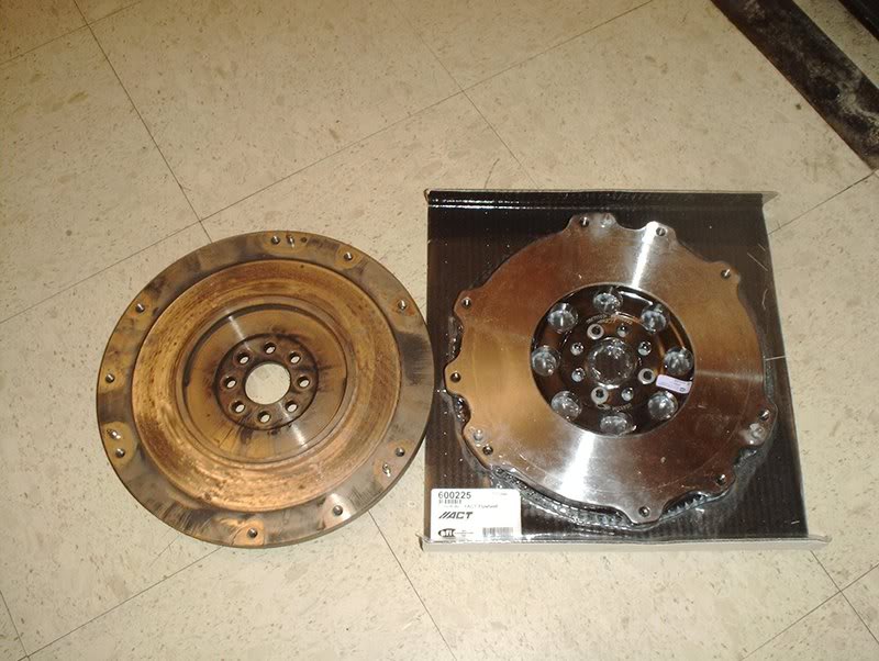

I decided to replace the stock flywheel with a aftermarket unit.

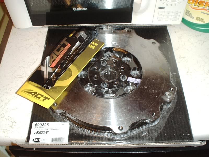

ACT Streetlite Flywheel part#:600225. I was going to get another brand but read that the chromoly forged one piece design was better and would not separate...porbably because it's one piece huh!
OEM vs. aftermarket flywheel. The OEM flywheel weighs in at 22lbs. and the Streetlite flywheel is 14lbs.
