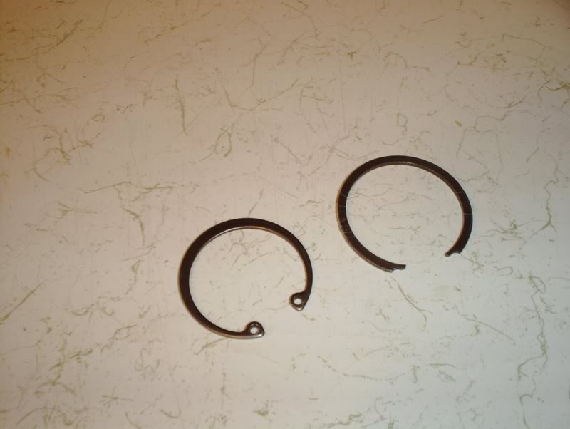

Shifter Snap Rings Fixed!!!
Alright, I finally managed to fanagle both those shifter rings into place. After that I put my console and glovebox back in so my interior is back to norm...just needs a good cleaning, cobwebs and dust. I had my ECU on upside down so I had to fix that. I also broke out the zipties and cleaned up the loose wires in the bay. I ziptied them together and hid as many as I could. I still need some of that covering for the fan wiring. I ran the engine and tested the new gasket on the water neck and it's fine...no leaks but there was a leak on the bung in the S14 water neck so I pulled it out and teflon taped it, threaded it back in and it's no longer leaking. I think I am finally leakless...yes!!! I started the engine again and revved it slightly and heard my bov for the first time...friggin' sweet! Tomorrow I have to put that extra exhaust gasket on to close up the leak where the downpipe meets the cat and fix the bolt situation on the driveshaft carrier bearing. I thought that the bolts for the center bearing and the transmission cross member were the same but apparently they weren't and we got them mixed up so now I have to figure out which bolt in the tranny crossmember is the one for the center bearing, pull it out and put the loose bolt that I have in. Test drive tomorrow!!!

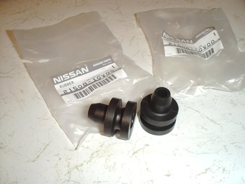

Radiator Feet
I got a set of radiator feet in.
Part#: 21508-10V00
It's raining out so I have to wait on the exhaust gaskets and carrier bearing bolts.

  #309
positron's Avatar
Posts: 1,192
From: Starkville, MS.
I went out there tonight and put those radiator feet on the hard way...with the hoses intact and fluid in the rad...and by myself to boot. Let me start off first by saying to anyone who plans to do the swap, make absolutely sure that you have the feet on the rad before you put it in because it is an absolute PITA to put them on a completely setup rad by yourself. This would have been much easier in the daytime and with a friend to help but I'm always the only one around when I do this crap! By taking the battery out and removing the radiator brackets, I was able to shimy the rad up maybe an inch which allowed me to slide the feet on. THIS IS NOT EASY TO DO BY YOURSELF!!! After that I topped off my rad and let the car run for awhile with the cap off to bleed it. I then took a short spin around the apartment complex. I then came to a big conclusion, either I'm out of practice driving a manual or that stage 2 clutch is way to stiff for me. Either way I'm happy because I got to drive my 240 for the first time in some time. I need to get my stickers and then I'll get on a dead road somewhere and get some boost for the first time.
