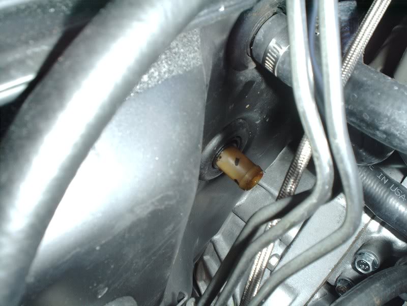

I took the S-shaped heater hose off and the nozzle is intact but it appears that the rubber seal around the nozzle is bad which is causing the leak. I've checked Courtesy Nissan and the part(rubber seal) is no longer available. I'm thinking maybe try the junkyard but if I can't get one could I use a RTV or something to seal this up?
They no longer sell this seal! I'm probably not going to be able to remove one at the junkyard without destroying the seal.

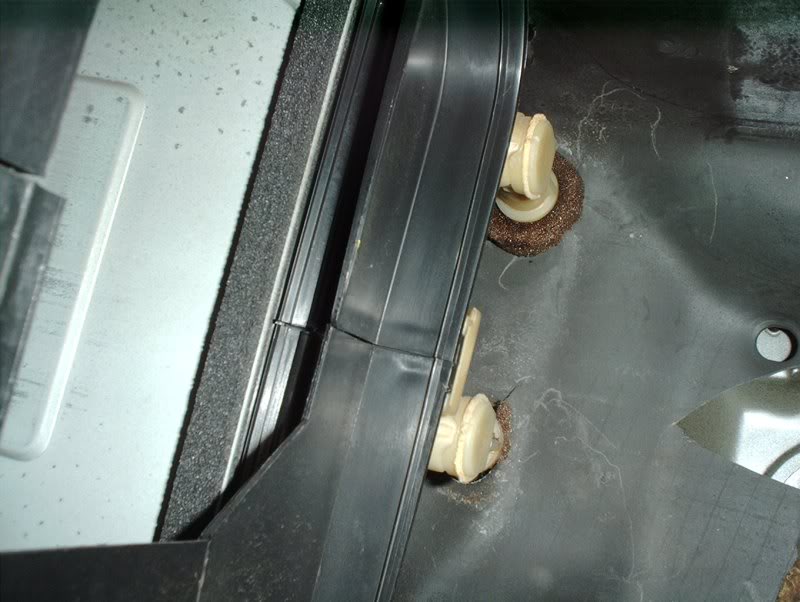

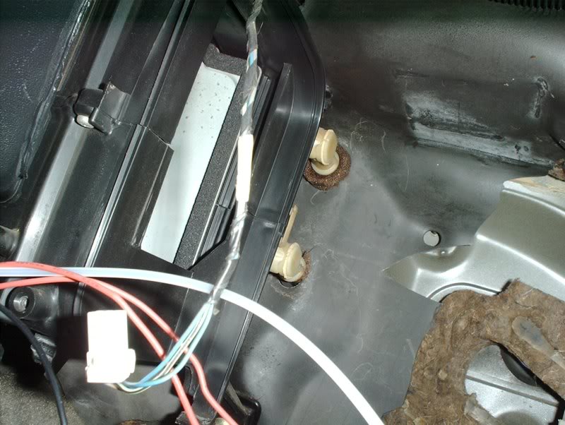

Okay I went out there and removed the cooling unit to see if I could gain some kind of access to the side of the heater core and spy a leak and this is what I found.
No leaks on the inside, so I put the hose back on the nozzle and tightened it down and the leak seems to be gone. I guess I just wasn't tightening the hose clamp down enough...probably in fear of busting the nozzle.
I just went back out and checked again and there is just a trickle of coolant that looks to be just some excess that was on or in the rubber firewall stopper. How tight do you think I can clamp that hose down without busting the nozzle? Thanks to Biggamehit for the tip on the hose tightening.

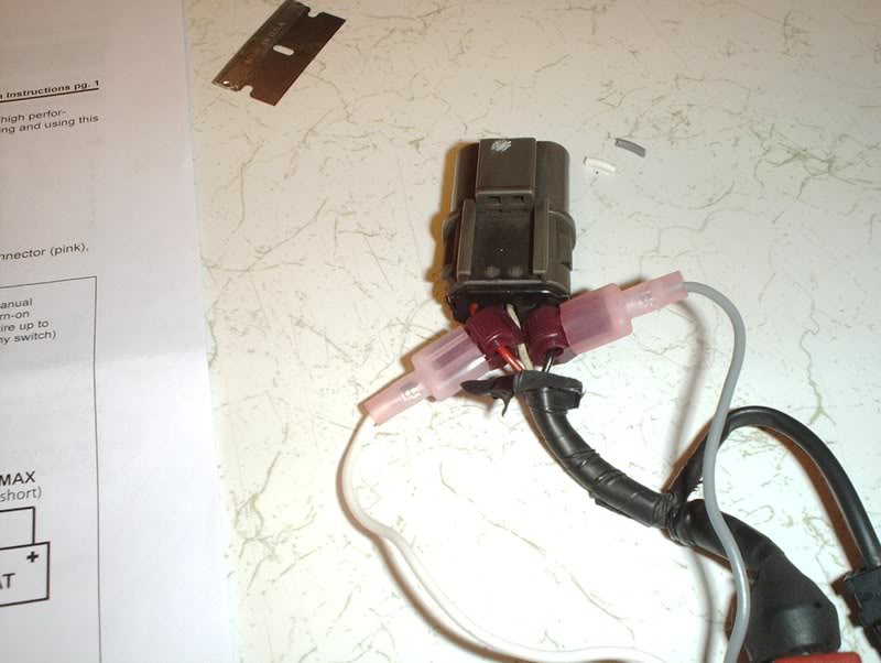

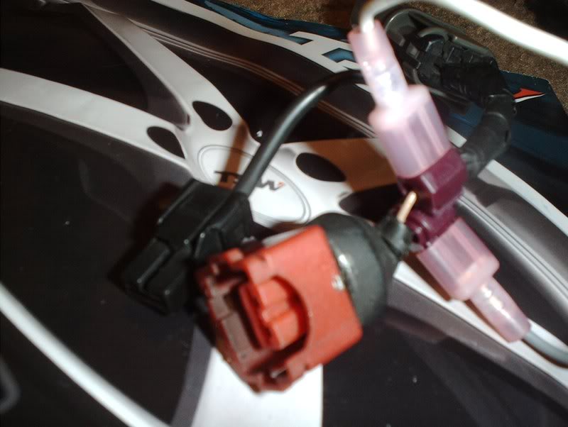

I went back and looked over the thread and remembered that I had the taps for the white and gray wires on the ECU part of the harness...
the first time that I did it but like a dumb***...
I redid it to put the taps on the coolant temp sensor part of the harness but the pic on for the SR setup on FRSport clearly has the taps on the ECU part of the harness next to the big gray plug like I originally had it so I'm gonna try that.
