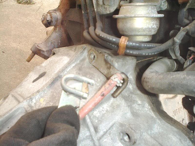

Does anyone know what this thing is and where it goes?
looks like the little breather thing that hooks on the hose coming out of the tranny

Sweet! I'm gonna get on that. Thanks to Bumnah and Durdan. Also thanks to motegineon, I would have never remembered where that part went.

Thanks for the tips, went to the KA and here is where the "thingy" goes. On the transmission like everyone said.Name:  crap.gif
