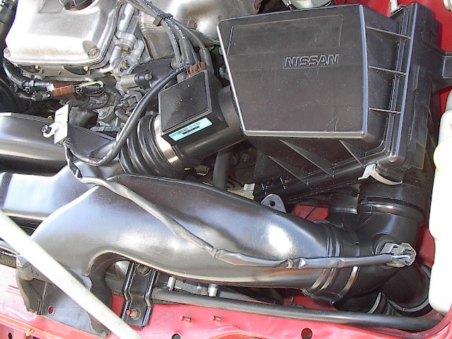

I have 97 and I think its a sensor or not but on the y-looking pipe that connects to the resanator there a wire with a sensor that goes in the pipe.I took in out and the car idled fine but i dunno about losing power or gas miles.If i do take out the pipe where would i put the wire and sensor.

probably the IAT sensor... it has a purpose, if we're talking about the same thing...

i think maybe.but i took a better look at it its not a sensor in the pipe its just a clip on thing like your o2 snsor is connected to to a clip thats what it is.

see for urself

its the one on the bottom right of the pic.
