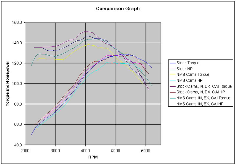

Originally posted by MasterOSkillio
I am curious about this mod after I get my car fixed, but I don't seem to understand some stuff.
3. Does anyone have any dyno sheets that compare hot cams swaps to stock or other aftermarket cams?
IMO I don't see how people claim the hot cam swap makes power. I showed this dyno earlier, it was done by NISMO. NISMO actually made the 248/248 set up as an upgrade and it wasn't proven to make any significant power.
