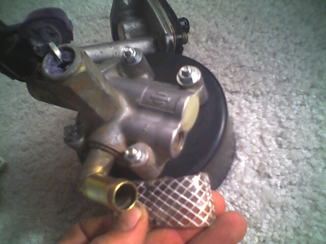

been awhile since i updated, ive been really busy with school and other things, but have faith, the project is still underway!
ive been doing things slowly, one at a time. just got the iacv or whatever nissan calls it connected, so the computer will still be able to give fast idle when the car is cold
for my vac. solution, i will be using the egr ports on the bottom of the stock runners for vacuum. these will be hooked up to a big canister, serving dual duty as both my vacuum source for brake booster, fpr, vac guage, and pcv system, as well as being the inlet for my fast idle circuit.
dirty details
materials: two 3in. flat sewer pipe cap from home depot, 3ft of 3in diameter sewer pvc pipe, section of silicon hose to make gasket, and 4 2in bolts with washers and nuts.

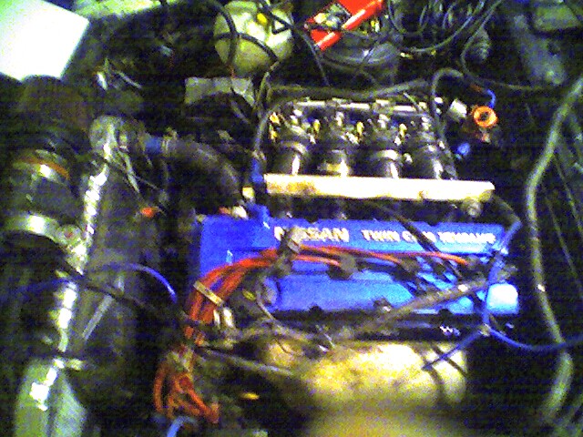

started install! more updates 2morrow with hopefully better pics. so far have old manifold and everything out,
new one is in, modifying plenum a bit due to .......uh.....design difficulties!

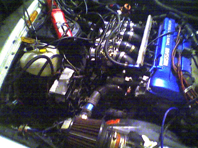

another
