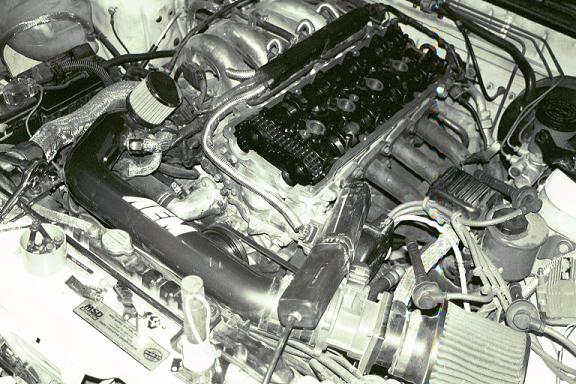

interesting breather placement
If you want to advance/retard your timing, take a 10mm socket and loosen up the nut on the distributor. It'll be sticking out of the head.
[IMG]001_01[/IMG]
Loosen that and slide your distributor all the way towards the front of your car. That just advanced your timing, a lot. Start it up, it'll ping like you're running cheap gas. Loosen that 10mm nut again and slide the dist. towards the back of your car slowly until it stops pinging. Wait..your car doesnt start. Well, do all that stuff until it starts up. If that doesnt help, its not your timing.
If you want to advance/retard your timing, take a 10mm socket and loosen up the nut on the distributor. It'll be sticking out of the head.[IMG]001_01[/IMG]
[IMG]001_01[/IMG]
[IMG]001_01[/IMG]
