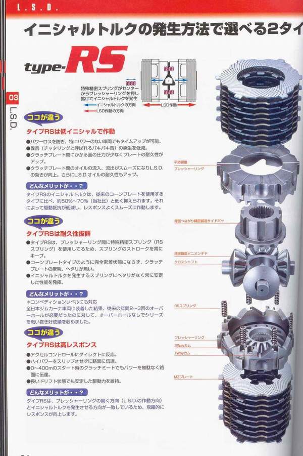

Cusco LSD is top notch! You can customize your LSD: RS or MZ, full carbon plates or semi, angle cuts, 1/1.5/2 way (need R180 or R200 for some vechicles), and rebuildable.
Attached Thumbnails (another LSD ?) Which of these LSD's should I get-rs-cusco-lsd-pic.jpg

Thanks for the info!
Sounds good, but how much is it? Carbon plates sound expensive. ATS also had some carbon plate diffs, but I don't need that for street driving. The Kaaz is rebuildable, and they have offices in the US, so you don't need to send it out of country. I bet it the Cusco is good, but I kinda like having support (more) locally.
