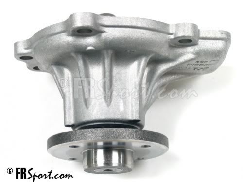

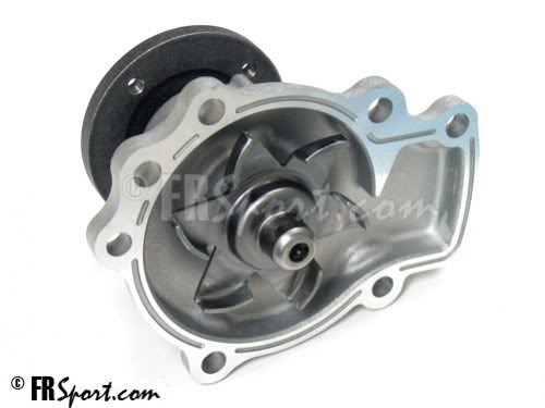

i pulled off my waterpump and it was so nasty it looked like it has spagetti sauce on it.i replaced it with a s14 SR20 water pump direct bolt on and it flows better then the s13 sr waterpump
i have no idea.... the flange on either one of the water pumps i have are slightly different, you can see if you scroll up and look, although the bolt patterns are exactly the same....
battosaii930.... i'll keep that S14 water pump in mine in case this one goes bad... you think a S15 pump is any different? shouldn't be....
all rwd SR20 water pumps fit im pretty sure the S14 uses the same water pump as s15.
and remember s14 SR is not called blacktop its called notchtop the blacktop is the s13 sr anyway yea ive had my s14 sr waterpump on my redtop for a while no problems at all
