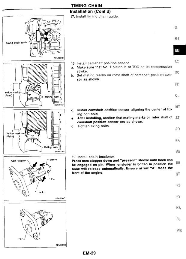

just incase your not sure how the CAS go's in
also TDC is second notch to the left on crank pully and the notches in the cam should be at 10 oclock position for intake and 12 oclock position for exhaust
thats the same guide i used... even printed it out, awesomesauce for taking the time to find it and post it...
i know what i did wrong, i used that image you posted, but the gear lengths are longer than what it shows there so the gear on the CAS spins too far to the right to match whats on that image... i had a buddy of mine come over and tell me exactly what to do..
