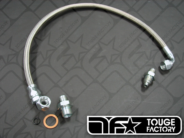

i also picked up a stainless steel braided ISIS high pressure power steering line, to replace the OE one that exploded on me two weeks ago... going to match my 1pc clutch line nicely....
