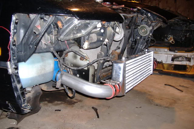

Here are some pics till I can get through the snow and get into the garage again.

Hate doing the wiring!
Left shot
Right shot
Top Shot
I still need to secure the intercooler. It should pull it up and closer to the car. There's enough movement if I need to make adjustments to get the front end back on.

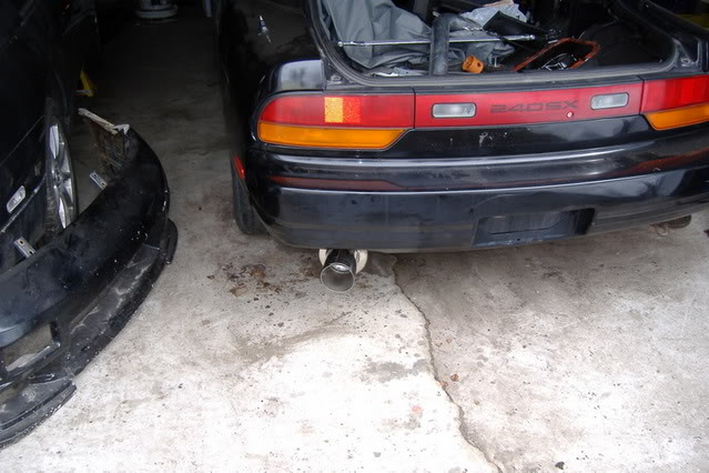

From: Binghamton, NY
Back end of the exhaust is on. Just got to add the downpipe and it is done!
I like the way it is positioned. Not to far out and in, just right. I think adding the downpipe will push it out just a bit, but not much.
