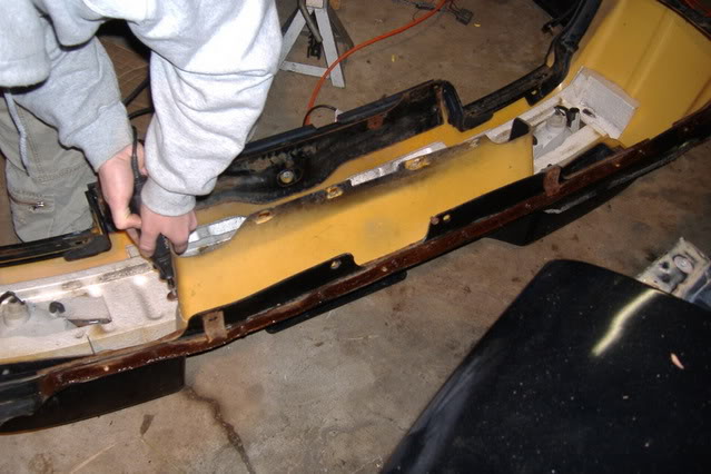

Got to kill some hours in the garage tonight. Threw the driver side fender, and front end back on.

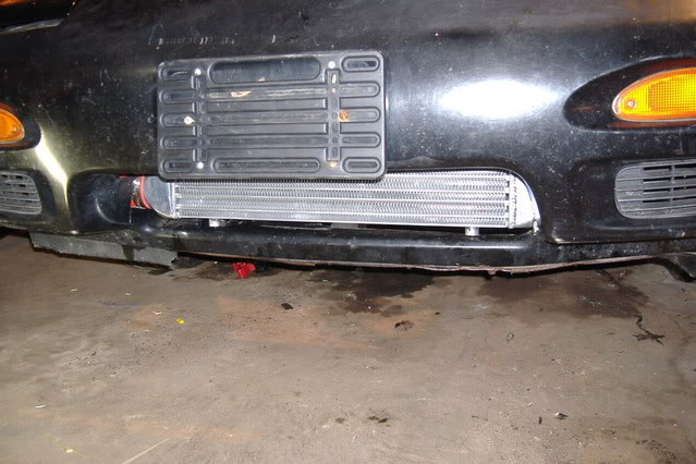

Cut out the side lips, and the intercooler sits nicely within.
Who doesn't like seeing this through the front end!

get a pignose

Looks good man now if it only would start!!

Originally posted by cronux
get a pignose
this summer i'll be transforming some body parts. i'd like to get something that shows off the intercooler a little more.
