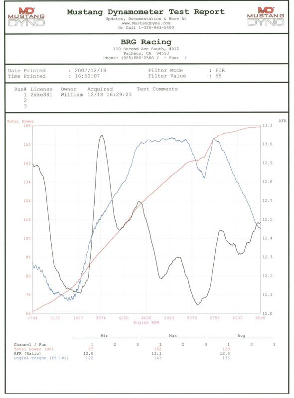

Sorry guy's it has been awhile.
Finally dynoed the engine with 95 octane, and stock (20btdc) timing. The results are very impressive.
Can't wait till the PDM cams, and my ported intake runners go into place.
All most finished with the runners. Please keep in mind this was done on a mustang dyno, a dyno jet would of showed higher gains, not to mention I didn't advance timing is stock!!!
Shooting for 185RWHP when the manifold, and cams are installed.

i'm not going to pretend to be an expert so could you explain what the deal is with the torque and arf?

Well the problem is that the SAFC isn't an excellent tool for adjusting the A/Fr's, to the stock ecu. What you are seeing is a manipulated stock A/F ratio. If that A/Fr was more tuned via ecu (fuel MAPS) there could of been room for a lot more HP, not to mention changes to ignition timing.
Secondly it was harder to tune using the N60 MAF. Why there was a drop in torque was simply because the mixture went super rich where it shouldn't of been causing it to drop and come back up.

that's kinda what i figured thanks.
