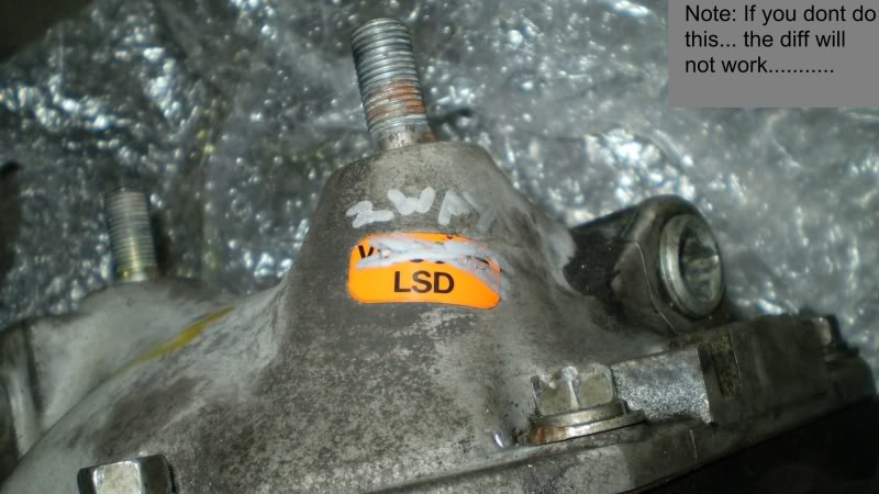

yea nick it would look like this with the sensor coming out of it.
this picture is from my R33 lsd swap.
ps
VLSD is good up until you need to overhaul it. if you don't plan on drifting hardcore with it, you will be fine.
haahah ****s and giggles

oh yea VLSD is very good now you dont have to spend money on that haha
ok just to make sure it is ABS when u look at the diff close to the drive shaft does it have sensor with a wire coming out of it?
would be best if you can take a pic then i can confirm if its a ABS Diff or not
Ill get under there tommorow and take a few pics..that'll save me the headache... thanks...My mom..(here we go again, make fun of me! but ithink this is sick! haha)
my mom said shes gonna help me financially with the 5-speed swap, she said if i get it started, then shell give me her credit card and i can order whatever i need, and so far the only thing i cant find is the drive shaft. !

So if theres a wire coming off of it, i have ABS? and if not then i dont. simple

yeap.. also.. look in our fuse box, if you have an actually spot for an ABS fuse, that just proves even further it is abs.
If you can get your vin number.. put it into google and you will get the brake down of your trim level.... however with VLSD SE based, im sure its ABS.

240 abs sucks though im pretty sure u can get a stock open differential from a s13 pretty cheap and swap over the VLSD internals from yours then u can use a normal 5speed shaft
Old Feb 16, 2009 | 08:34 PM
  #141
you don't have to run abs.. just disable it.. there is no need to change hardware. the only reason i swapped my pumpkin was... it was already backlashed. all i did was get the tail end of a non-abs drive shaft to make up the distance.
