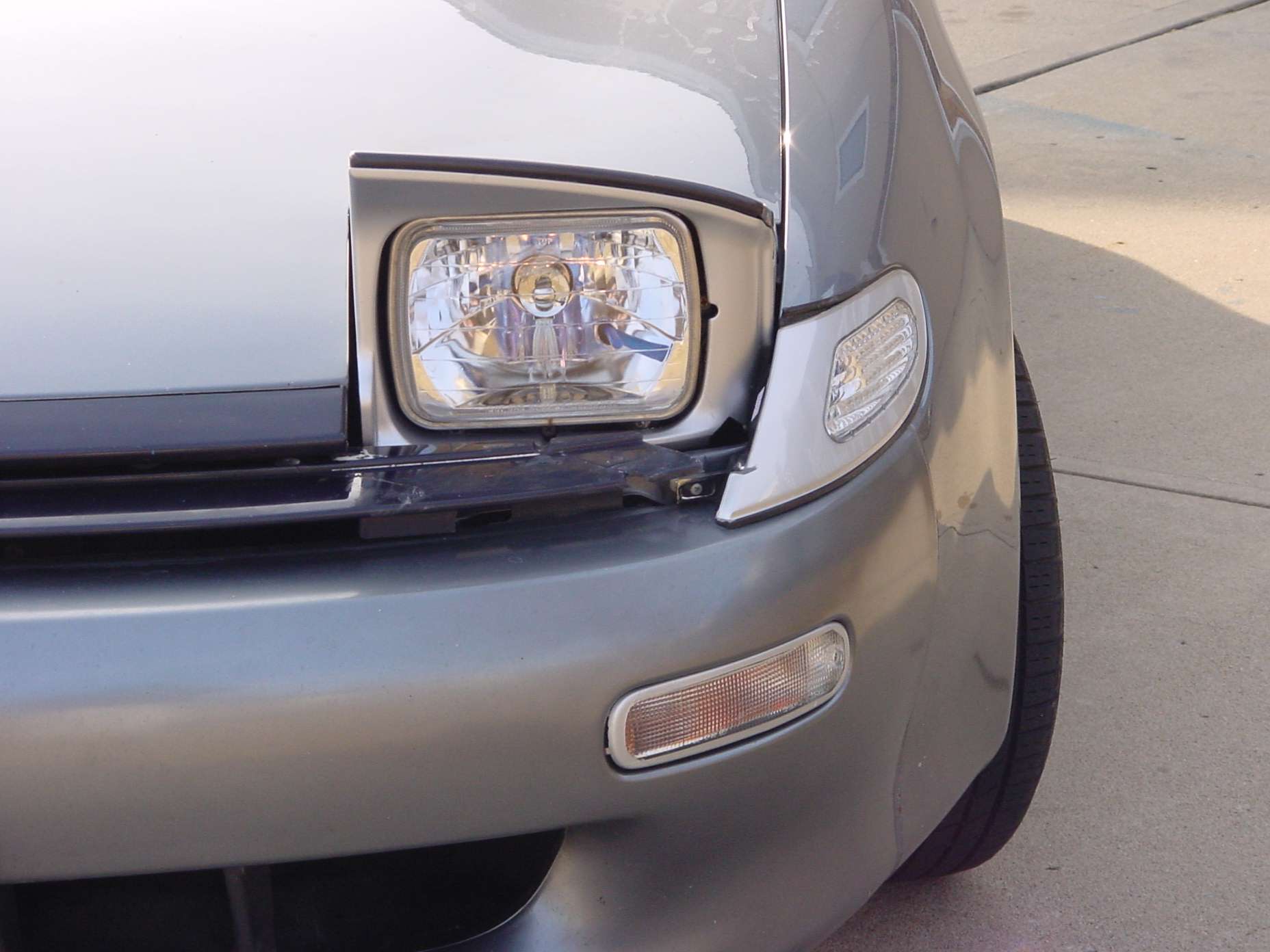

You say the front pic of my celica is gross? I get compliment everywhere I go. Kinda judgemental to say something when you haven't seen my whole car. You sure know how to be nice to the guy guy that just got his 240 you sack of sh*t. No wonder barely anyone talks on this board. On the celica website thousands of people are on it each day. You sure know how to make me feel welcome.

dont yell at me 'cause your car lights are ugly and jacked up!
are you that insecure that you REALLY give that much a **** what i think about you car? your getting going to get upset because someone doesn't like how your car looks? and if most people REALLY thought your car looked good, then why worry about what one or two people think?
get a life
Blackouts??? What is this, an '86 IROC-Z?? I'd like to be the first to welcome you to 2003, lots of things have changed since the time when big hair, acid washed jeans, and white Reebok high tops were cool.
club240 and terror give your celica two thumbs down.......
1) because a 1990 celica is ungly aws hell
