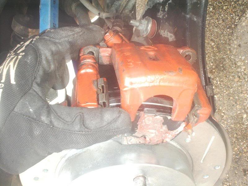

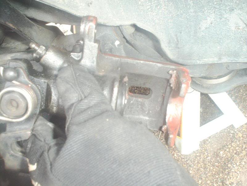

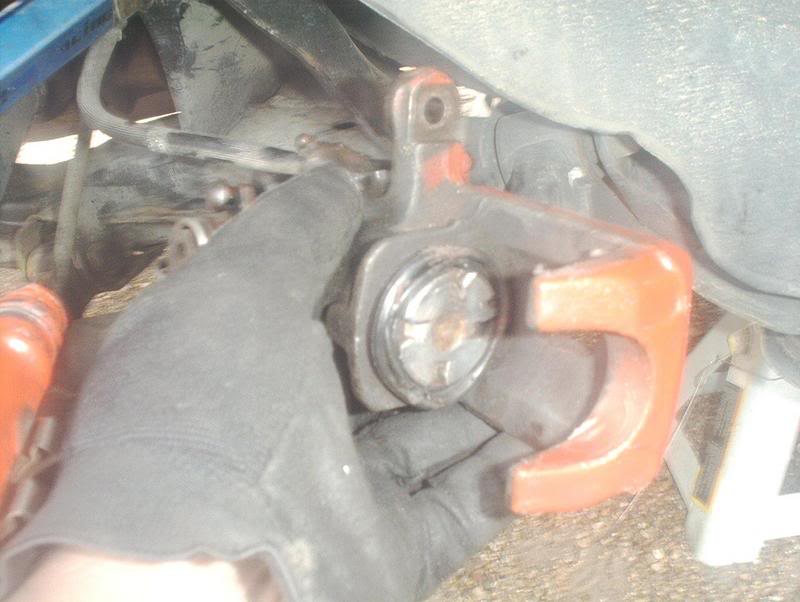

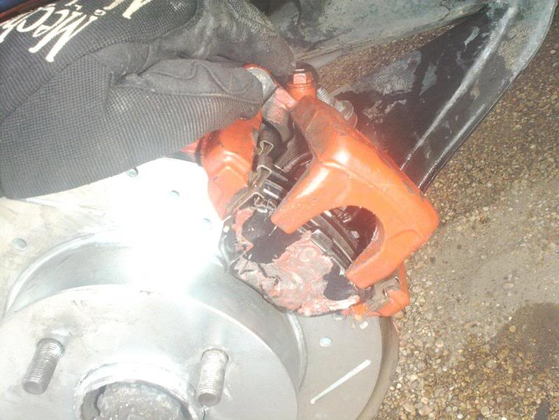

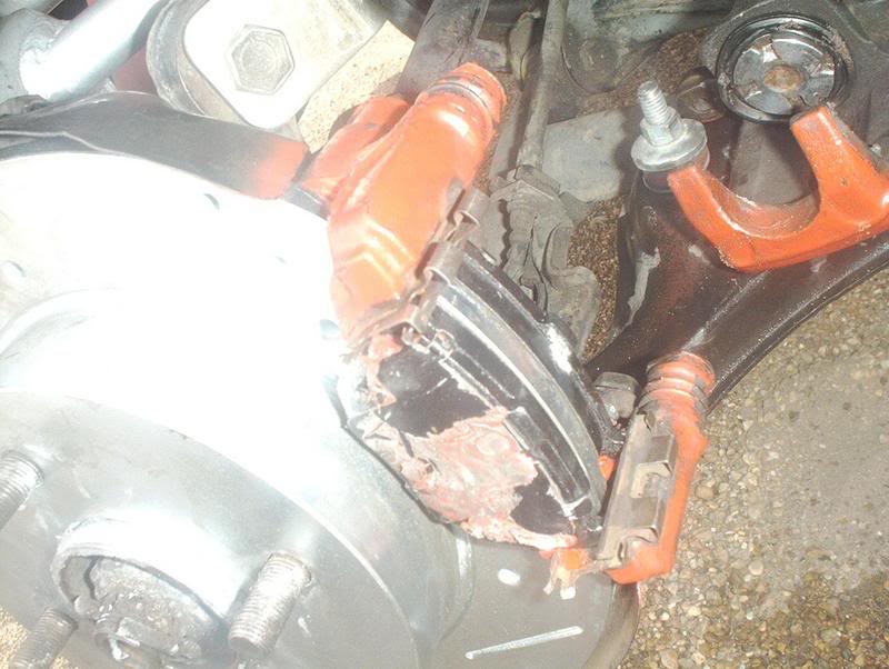

The piston is flush with the rubber boot but the caliper will not fit over the new pad rotor combo...it's just too tight and there's no room for the wheel to move.
